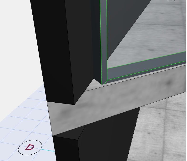

how could i make this corner cleaner ?
on the left is a 250mm wall, then a basic facade emenent and then the slab with the sharp corner.
any stratgey on how i could clean this up, bring every thing in line with the sharp slab corner.

If the wall is not a composite, use POLYGONAL WALL.
Bruce
Or you could put in a short segment of wall along the other edge of the slab, up to the window, which will interact with the wall in question (or extend the wall that is housing the window in your image).
