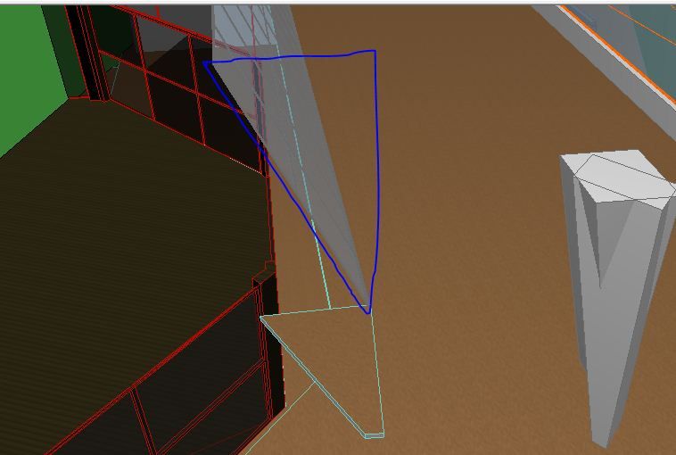

how i can make wall or draw in 3d
Hello every one i have question that make me not able to interact in 3d
i want to draw like the blue line to be wall i can not do this accurately except to draw on 3d how i can do it easily without suffer please guide me

Use Polygonal Wall.

i know this method and you draw it on top view which will not give me accuracy
i need to draw it from elevation or 3d so i paste it accuratly on tilted curtain wall ??
here the real problem i face

You could use a mesh tool to draw a 3d surface in 3D
So 1st draw it on the plan, and then raise its corners to their right elevations.
Thanks SPINCODE i will try and see if it goes as easy method
Use a zero thickness mesh and then convert it "mesh to roof"
to bring it some body.

You could also draw a 2D profile in the elevation and copy it to the Complex Profile Editor. Then you could use the wall tool with a completely accurate profile.
