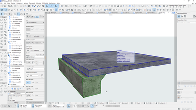

Slab for the top, complex profile beam for the bottom:

As Erwin said - complex profiles beams or walls.
I have my footings built into the complex profile walls.
They even have modifiers so everything can be stretched (the blue lines in image).
All I have to do is add my slab.
