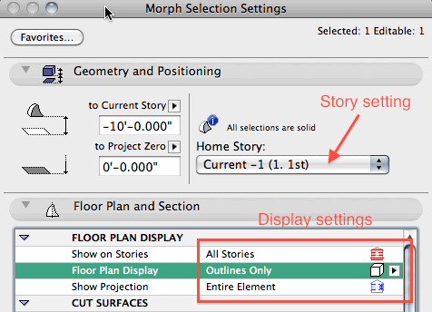

This is my bridge on the ground floor plan, some bits are missing they're on different stories. Is there a way i can get them all on the same story? and the Morph is cut in half and shows on different stories as well. I can't work it out.

Jimi:
See attached image for display settings to try. The story setting is also shown. You can use the Morph Boolean Operations > Union command to combine Morphs.

David:
I have tried the story setting, nothing got changed until I used the "Morph Boolean Operations", and it worked!! even though I still can't move them on to different stories.
Thank you very much!
I was very frustrated, and about to hand drawn them, now that saved me a lot of time, I can finally have all the construction details on the same level.
