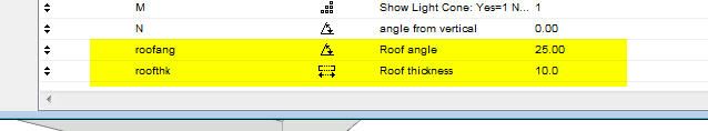

I am trying to generate a 3D interior view showing can lights in a sloped ceiling.
Can anyone tell me how to show this. As far as I can see the only tool that sticks to a roof is the skylight tool but I haven't figured out how to tweek that so I can make a respectable 3D can light.
can light=concealed ceiling fixture

I'm getting closer but it looks like the hole is always a rectangle.
I guess a rectangular prism with a round hole the same thickness and material as the roof could be scripted in to fill the gap.
I'm not sure if the hole can be turned off completely and then you add your own hole manually.

The only way I can see to turn off the hole is to trick it by setting the length(A) and width (B) parameters to zero.
But this will affect the size of the light also.
So new parameters would need to be added for the size (length and width) of the light fitting and all the scripts amended to suit.
Add the 3 lines of code to the 3D script that I showed in the last creen shot and that will reposition the light to fit the hole (but it will still be square).
You could just leave the subtype as a "Light".
Add two lines of code to the 3D script.
ROTx roofang
ADDz roofthk
Then create 2 new parameters - roofang (as an angle parameter) and roofthk (as a length).
Now you can use gravity to snap the light to the roof and you can manually set the roof slope and thickness in your light object parameters.
And manually cut the holes in the roof.
