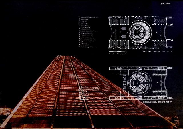

hwo to do this dome or this semi cone
i want to know how to do like this dome or this semi cone and also can it done by archiglazing and if there is othee methods please tell me i illustrated 3 pictures for clarification my question

There are always a number of ways, two are:
- the curtain wall tool
- using sloped walls
Erika
Architect, Consultant
Mac OSX 10.11.1
AC5-18
Onuma System
Another approach would be to use sloping columns with roofs for the covering and beams for the purlins. At least from what I can see the panels don't appear to be curved so the straight beams and flat roofs should work fine.
A substitue for the roofs to make the shell would be to use a mesh. You can make the circular or eliptical contours as needed and raise them to the appropriate heights. Then make a copy of the mesh, lower it by the appropriate amount and subtract it from the original. (The operator then needs to go on a hidden layer of course.)
