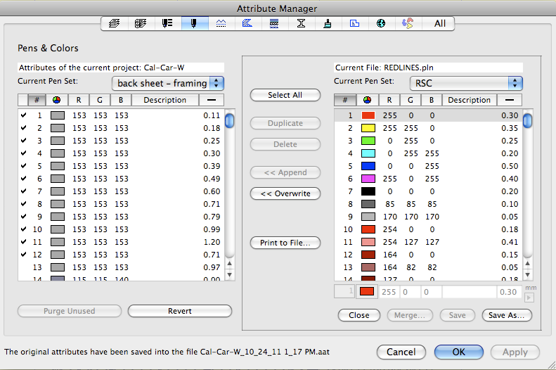

David - Great advice, only I can't figure out how to do the Append thing so that the imported pen set is added to my current project. Do I need to select something first? My Append button is grayed out. Attached is my Attributes Manager window.

Click on the tab called Pen Sets. The one you show as selected is Pens & Colors. You can append Pen Sets but not individual pens.
