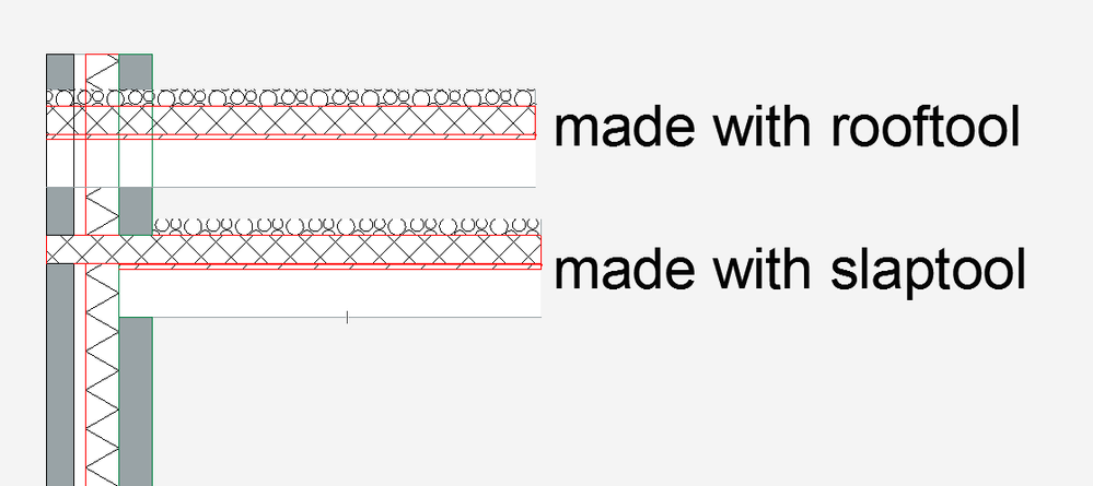

Intersection priority between roof and wall doesn't work. When I try it with a slap it does work, but I can't rotate a slap in the section.
I also tried the solid tools but that don't take into account the intersection priority settings.

Roof elements don't automatically interest like wall and slabs do, need to use the context menu and connect. Please take a look at this help page for more info.
http://helpcenter.graphisoft.com/guides/archicad-18-int-reference-guide/elements-of-the-virtual-buil...
