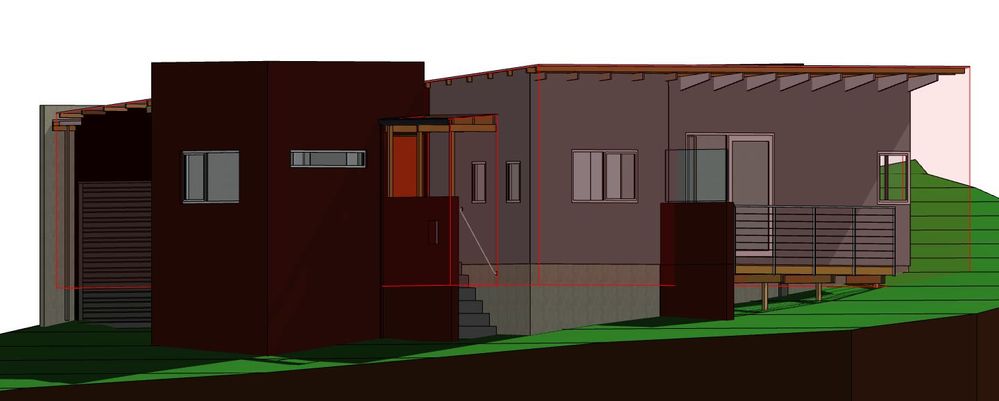

What are these vertical and horizontal lines on my perspective views. How can i turn them off.

They are your roof trimming bodies.
You can turn them off in the VEIW menu > On Screen View Options > Trimming Bodies.
They won't print or render if you don't turn them off.
KeesW
Thanks Barry. I wouldn't have thought of that.
