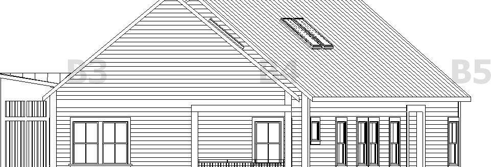

material not showing in layout

here is the layout

shrink slab so it doesn't show. Use one two-storey-high wall instead of the ones you've got.

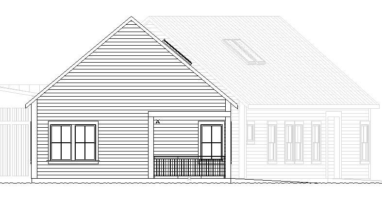

Are you sure it is the same material to the slab edge as the wall above?
I'm also wondering why the marked distant area shows on one but not the other? I thought they were the same view? I'm not sure why that might affect the display of a material fill though.
Check the Model view options too, I'm not sure if the options for fills have an effect in elevation or not. Might be worth checking?

yes it is the same material, the distant area is like that due to true line weight differences. I ended up just using a fill. I could not figure it out, all the other elevations were showing it fine.

I would check the settings of both the views again.
If all else fails, set everything as it should be manually, select the proper view, open the settings, and Set to current window - that would correct any discrepancy that you might have forgotten to set.
