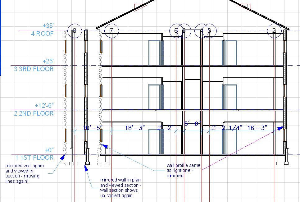

UPdate:
i checked on the module i am hotlinking and when i cut a setion one direction the wall profiles show up and when i cut a section the other direction, they disappear????
anyone have a thought?

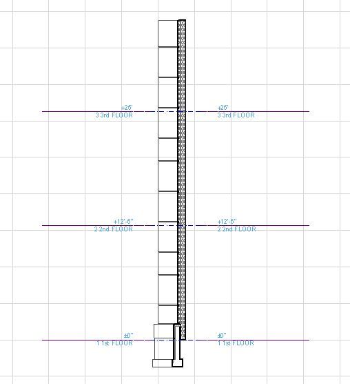

updated - section looking other direction on wall

I've had the same issues with complex profiles and have never found a fix unfortunately. I ended up just drawing 2d lines over top.

there was a mention of over-lapping walls, but no mention of layers.
check & see if there are walls of different layers but in the same location.
this is simply fixed by changing the intersection properties in the layer settings...
