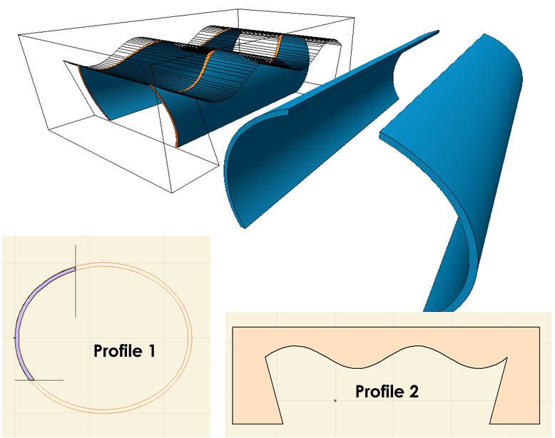

Hi Danivici,
Make two profiles, one of the cross section of the screen (profile 1), and one of the cross section of the curved shape (profile 2 - perpendicular to the screen). Use SEO to subtract one away from the other. Leave the carving shape in place but put it on a hidden layer.
I've used the complex profile tool (in AC10 and above), but you will have to use the profiler goodie as AC9 doesn't have this. There is probably a link on your 'Help' menu to the goodies if you don't have this installed already.
Hope that helps!

Just another comment on this, depending upon what Danivici really wanted...
The illustration that Peter gives will provide the cut shown in the original elevation, but this may not be the cut desired for construction.
Given the curvy cut of a curved surface, and assuming the construction materials are metallic skins, I would think that the desired cut would be perpendicular to the curve tangent at all times, giving a 90 degree edge at all cut surfaces. This would allow pieces of rolled material of a fixed width to be attached (welded?) for the edge.
Unfortunately, we cannot model this in ArchiCAD. We can take a profile similar to Peter's and apply it to a column or beam and anchor the profile at the origin of the circle defining the curved wall to approximate it. But, there will only be a true 90 degree cut for that one anchored point - all other parts of the cutting curve will be at other angles.
Dwight's tips on combining profiles with profiled cutters are really very helpful though!
