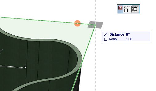

Things seem to go along just fine till I try to get the top plane only to modify.
I keep getting the whole vase selected and with the "box" dialog and this modifies the morph in lots of ways to the whole vase, but I can't find a setting to get the top plane only (as in this image) to adjust.
I've watched and rewatched to the movie and somehow don't see what I'm doing wrong.
The image here is from the movie, the next post is what I get.

Yes it is a bit tricky.
Select the top morph face (use the Ctrl+Shift click on the top face), you will know you've got it when the morph has black dots along the top edges, then click on the edge (not a dot) choose the box stretch option ... now when you click on a corner of this highlighted plane your pet palette will have only 2 options. Choose the second one.
In your image, you will see three options in the pet palette. Also you will see that your cursor is aligned with the back face of the morph volume.
PS Another clue is that you don't want to see the morph volume highlighted, only the top plane should be highlighted.

Oh Yeah, getting to the black dots was critical.
