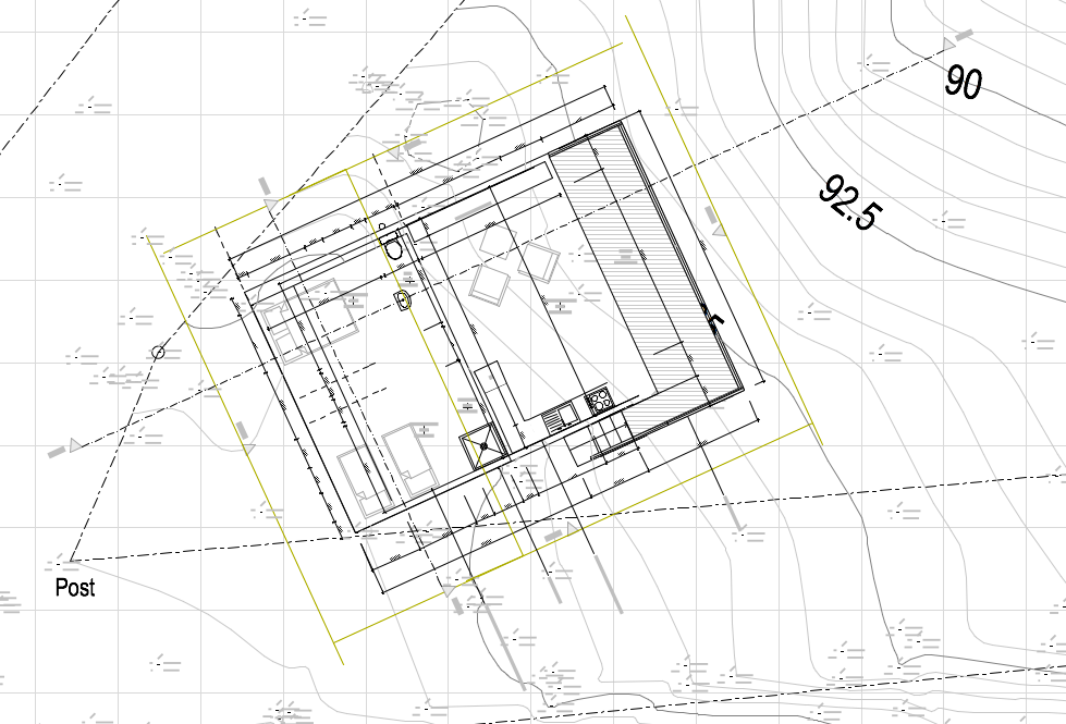

moving model vertically I lose my walls in plan
hi All
I hope some one can help me
i've built a model in osx Ac14 and I got the topographical survey
after doing so.
when I built the site model I then moved the building model up to its
correct spot level.
but my walls in plan have all disappeared.
does anybody have any clues of what I could do.
so far i've been fiddling with the project zero setting without success.
any help would be really appreciated.
thanks in advance.
cheers

Bobby:
If the walls are set to anything other than Symbolic Cut, then this could be a Floor Plan Cut Plane issue. Another approach when importing a site survey is to leave the architectural elements at their original heights (at Project Zero) and use he Reference Levels to establish heights above Sea Level where needed.
