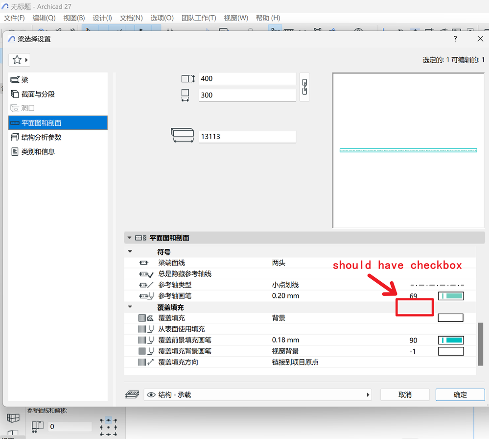

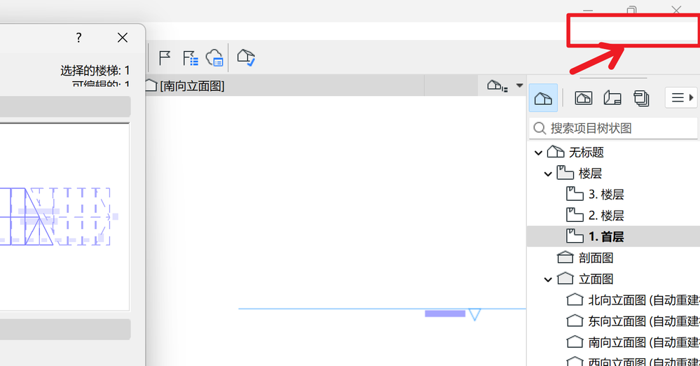

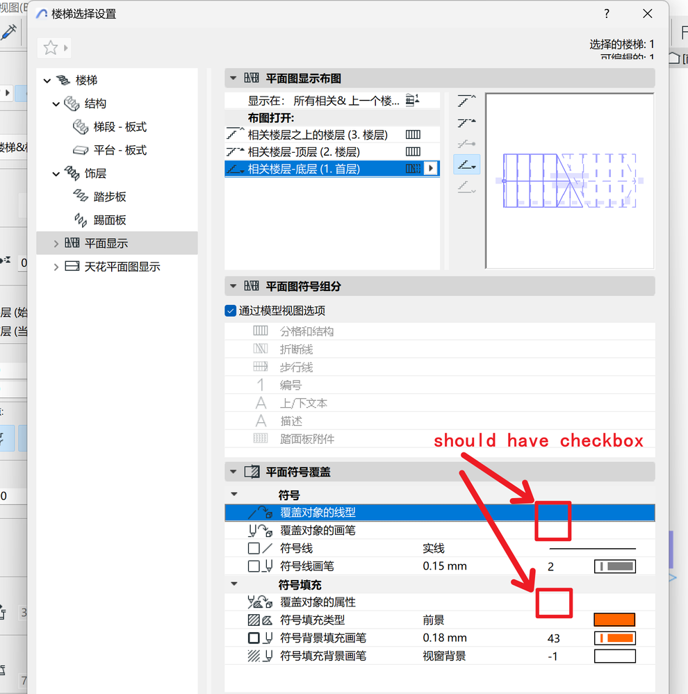

Hello guys, my archicad 27 interface have some problems. There should have some checkbox , but now they are gone. And the minimize buttons are gone too. I reinstalled the 27, it does not work.  Archicad 26 is fine.
Can someone help me out?

And I found two interesting things.
1. I uninstalled the goodies plugin, reinstalled it. It works. except the up right corner 3 icons  😞

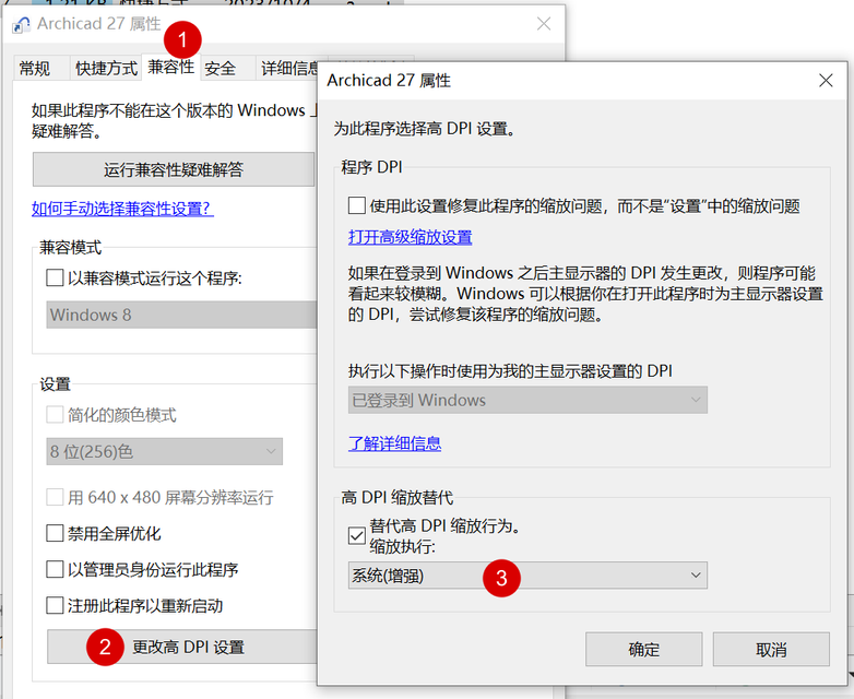

2. But,  when I set the the Hi DPI zoom to "enhance" as pic below. the checkbox disappear again. But my original question is not caused by this Hi DPI settings.

Sorry I fogot upload the image. It is not the scale of the screen. It's the properties of the programe.

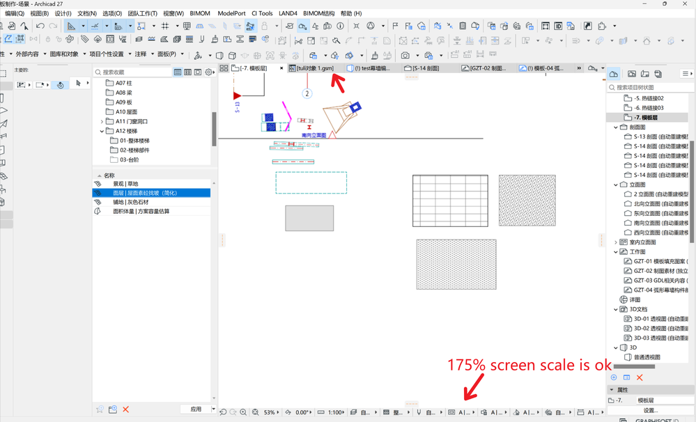

Funfun Yan
Screen scale will not affect this checkbox issue. but will affect the display of the "quicke option bar".
When there is a gdl obj is open and edit. 200% screen scale , the "quicke option bar" is gone.  175% screen scale , the "quicke option bar" is back.
When there is no gdl obj is open, the "quicke option bar" is alway there.
