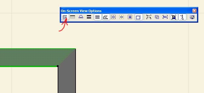

1) You probably have 'clean wall/beam intersections' turned off in the on-screen view options toolbar (see attached picture). Walls automatically join when they meet on any edge or corner when this option is turned on.
