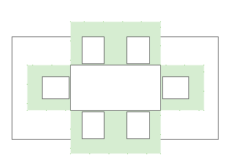

does anyone know how to get rid of this green fill on the objects?

Which object is this?
Check to see if you have Minimal Space to show.
You will find it under 2D Representation.

Its a dinning table, on the the furniture layout library.
Rod, it worked for other object that had the same green fill, but it wont work for this object nor the couch object.

Please give us a Screenshot of the object settings... It will be easier to help you.

Si hablo español. Aqui esta. Here it is
This must be the minimal space parameter (considering you are using AC 13). You must turn off its visibility in the model view options window, under "Options for GDL objects" tab.
sorry, im new to this, i can't seem to find exactly where that is at
Nevermind I found it, thank you , gracias
