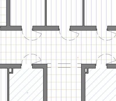

I have problem with zones in my project. I have some overlaping zones and I need them to be this way (as in the pic).

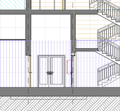

Everything looks fine in plans, but I can't make it look good in section. Even tho I checked the transparency option in section, one of the overlaping zones do not show, as if the hatch had white background (pic 2). There should be both violet and yellow stripes showing in corridor.

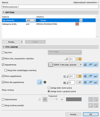

Here's e.g. my graphic override rule for yellow stripes (in polish):
Does anyone know how to fix this, or maybe how to make it work another way?

Maybe the Surfaces also need to be overridden with a color with 100% Transmittence value?
