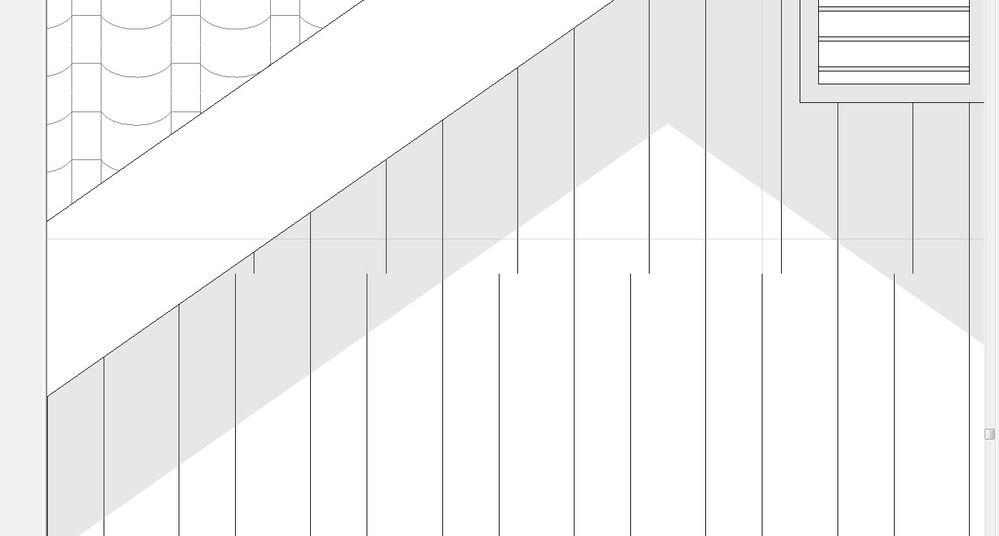

problem with vectorial 3d hatching
How to fix this problem with vectorial 3d hatching? Walls are on different storys and fills don´t fit.

arlis:
It looks like the vectorial 3d hatchings are running in the opposite directions (maybe the walls were drawn left/right and right/left). In the 3D Window, select one of the walls, use the command Align 3D Texture > Set Direction..., click on the wall, the Align 3D Texture dialog box appears, select Define angle numerically, and enter 180˚.

Stephen Dolbee
Another option: Select one wall (or the other) then, Edit/Reference line and plane/Invert wall direction.
