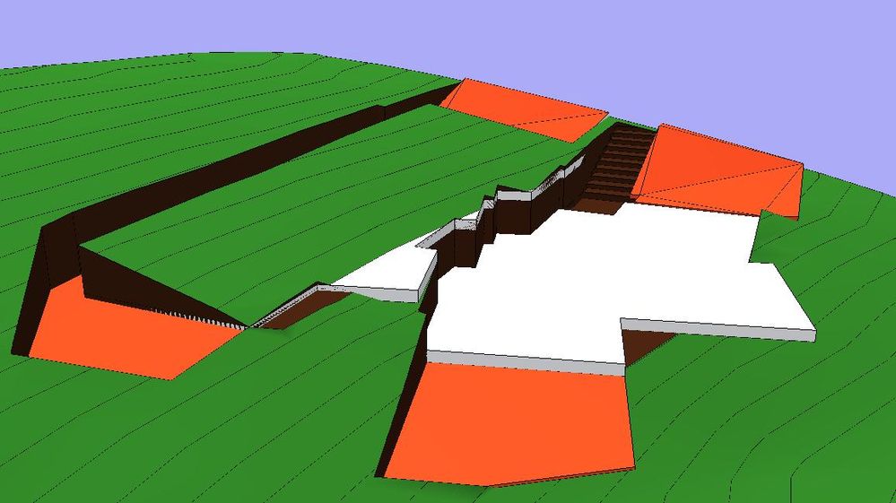

GeNOS wrote:Yes the numbers in the layer list.
how do i change the intersection priority ???? :S is it the number on teh layer under teh layer list? if so i made the slabs 2 and left teh mesh 1 and still no love
all the items are on differnt layers.

Barry wrote:yeah its one big mesh, and all the slabs defiantly start below the surface of the mesh, (some areas stick out the top but mostly are under the surface.. all the separate slabs and roofs are needed as there at different heights and angles.GeNOS wrote:Yes the numbers in the layer list.
make sure you change i tin the layer combination otherwise it will just reset back to what it was before when you use that layer combination again.
Is that just one big mesh? - maybe try breaking it up.
Does the slab actually intersect with the mesh? - if not no subtract with upward extrusion will work.
Maybe the red slabs are cutting away the mesh in a way that the white slab can no longer operate on it.
Try undoing all of the SEOs and the just subtracting just that one white slab.

GeNOS wrote:Maybe it is because some of the elements are completely below the surface of the mesh and maybe some are even below the base of the mesh.
GeNOS wrote:This could be the problem as well.
none of the elements overlap, so they are only cutting whats above them in the mesh.
GeNOS wrote:Keep all the separate elements but create one new slab that has the same shape as all the elements put together.
