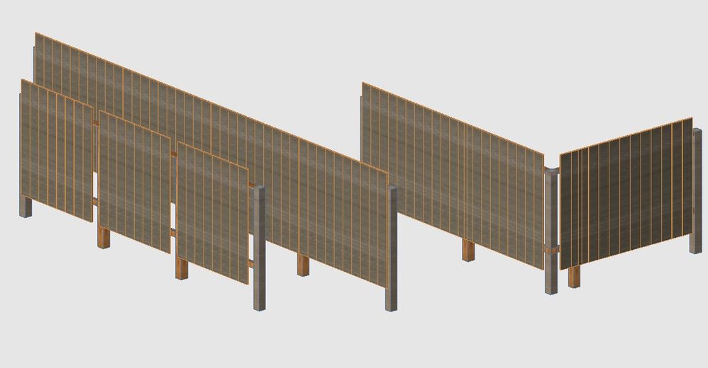

I have used Archicad for some time and fell proficient in most aspects. When it comes to the railing tool, I am reduced to frustration. I am an engineer and this tool and I do not think the same.
I was attempting a simple wood cedar Fence.
  • The flat cedar pickets will not start at the posts
  • Most often if a new length of fence is draw, there are also gaps between the inner posts.
  • The corners are also not closed.

I share your frustration about that rail tool myself and it could definitely be improved.
Are there any of those fence types in the object library that may help you ?
I created my fence using an invisible wall with columns for posts and the CI coverings tool for cladding and rails. You could probably use beams for rails too ?
Anyway that was my method others may be able to help you out.
Have Fun !

I would probably model the posts seperately. In doing this your posts and inner posts become your slats and it is easier to adjust the spacing.
Win11 | i9 10850K | 64GB | RX6600 Win11 | 5900X | 32GB | GTX2080TI
You may be happier with the "Fence Vertical 26" object shown with no posts, and adding posts manually.
