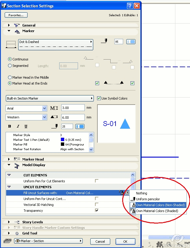

Not sure if this is what you're after but you could try Section Selection Settings - Model Display - try changing the 'Fill uncut surfaces with' to 'own material colours - non shaded'.
Screeshot attached.
HTH
i already had it set to "nothing" because the colour of the material of the edge of this roof is dark grey
i dont want it to show as a colour on the sections. this seems to be a bug in archicad?
