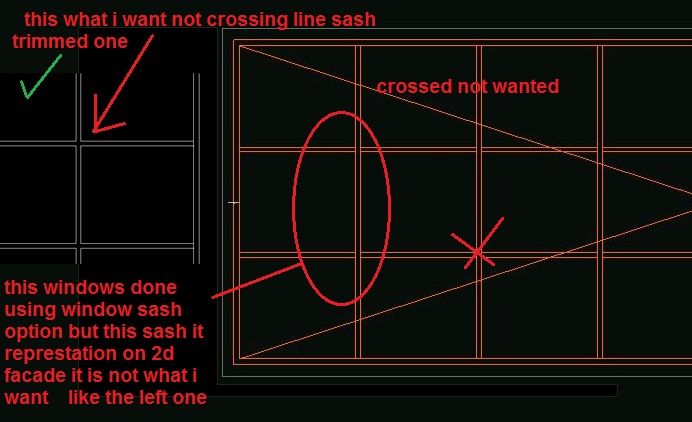

Hello every one my question when i place window on archicad and using sash its represent on 2d eleation is not trimmed on all edges how can i make it trimmed through setting in archicad (i attached my image to make my point is clear)
second how i can make opening line not appearing on elevation
Thanks in advance

Finally i found solution for this and i will not be stingy of course with this nice forum so i will share with you the solution i discovered
if you want what called grills or mullion in the window being trimmed during crossed line just choose in the window setting --under sash options --Editable Grid instead of H-V Grid (i attached the image for further clarification)
but i still do not know how to remove opening mark from 2d elevation i know it simple but i can not reach to the option removing it
Thanks for this nice forum
