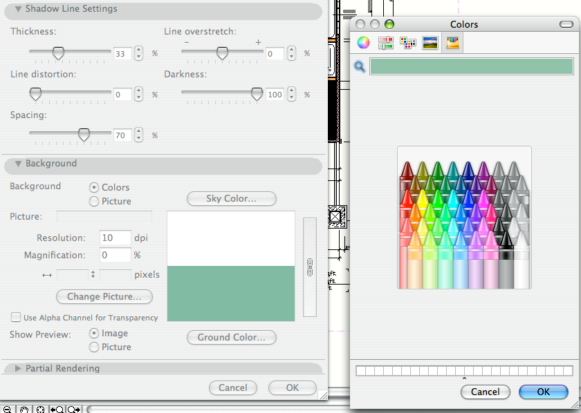

I have been trying to render a model with the sketch rendering engine. I set the photorendering settings of a view under sketch engine, and then execute the photorendering projection.(using Koh-I-noor) backgrounds with the horizon; sky and ground color are visible through the rendering. is there any way to fix it?

Please post the screenshot of your photorendering settings

select the color of the sky and the ground and change to white... that will give a white background. Is this what you are after?
