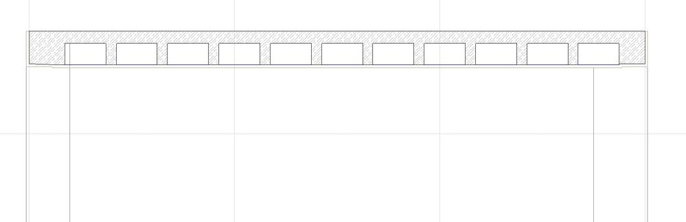

slab and beams with plaster
hello everyone. its a section. i want to ask how can i draw this construction? beams with plaster? i can put beams like that but i can not put plaster to beams.
4 Replies 4
It can be done with a combination of composites (for slab) and profiles (for beams); set fills/cut lines/priorities to suit...
thank you for asnwer yeah its ok like that but we dont need to see plaster at slab. i try to show it again.
Then I would do the slab and beam profiles without the plaster and model in a separate slab for just the ceiling.
James B
In the Slab composite, you can also place an air gap between the plaster and concrete. And then model the beams inside that air gap. Just make sure that the airgap building material priority it less than the beam concrete.
