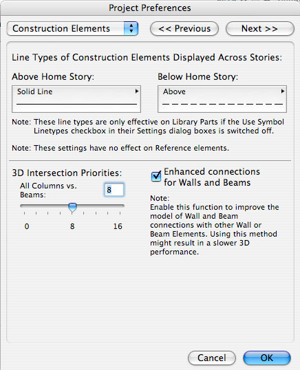

slab showing as dashed line one story down--why?
I am using the slab tool to model the floors of my current project. The floor outline shows as a solid line on the home story and a dashed line one story down. I want to show it as a solid line on both stories but I cannot find the controls for the line type for one story down. Please tell me where I can find the control for the line type for the slab when shown one story down.

Check out Options> Project Preferences, Construction Elements "Below home storey" (as below). Be aware that this is a global setting that will effect all overhead items.
Aloha Stuart,
Thank you for replying so quickly and accurately. I had forgotten about the global setting. You nailed it.
The problem for me with the global setting is that I want a different setting for roofs and slabs. Right now my work around is just to draw the solid lines for the slabs on the story below.
Thank you,
John

How can I fix this problem in Archicad 18?? and cant find that menu in this version.
Off the top of my head try Project Preferences > Legacy.
