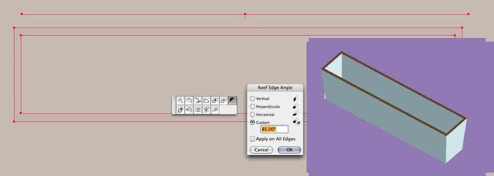

Krikey
CheapnNasty™ Windo box:
zero slope roof slab with edges tilted back.
Never mind about the cutout for soil - just make the top plane of the roof dark.
quote]
Dwight,
What do you mean edges tilted back?
Thanks,
John
Dwight
one of those context menu thingies.
Dwight Atkinson
