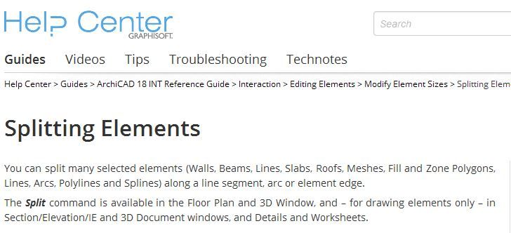

See the pic below for a quote directly from the help menu. Unless I'm reading this wrong, I should be able to split a mesh directly along an arc. Maybe it's an ArchiCad bug

There is no bug. There are two cases:
1. Splitting a linear element. It can be done by a Line, Arc or element edge. This can be achieved because it is easy to find the intersection point of the linear element and the splitting line, arc or element edge.
2. Splitting a polygonal element. This can only be done by a straight line or edge. If you want to split by an arc you will have to use a workaround like the one I have given you above.
On that Helpcenter page you can read:
You can split many selected elements (Walls, Beams, Lines, Slabs, Roofs, Meshes, Fill and Zone Polygons, Lines, Arcs, Polylines and Splines) along a line segment, arc or element edge.
The Split command is available in the Floor Plan and 3D Window, and – for drawing elements only – in Section/Elevation/IE and 3D Document windows, and Details and Worksheets.
Note: You cannot split a polygon – such as a Roof element – with an arc.

Looks like it's saying two different things. Is there any time a mesh or a slab not a polygon?

No, there is not.
A Mesh or a Slab is always a polygon - and it cannot be split with an arc, as the text says.
