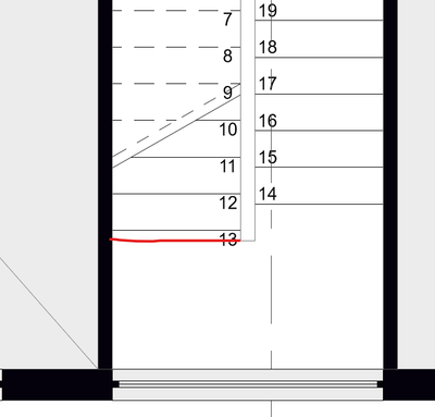

What is good practice for getting the top of stair 13 to line up with the red line?

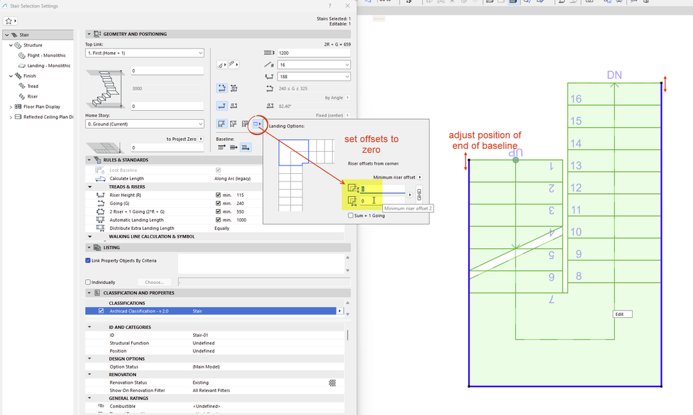

Set the riser offsets to zero and then adjust the baselines.
If you set the riser offsets to zero before you place the stair you will have better control as you place it.
