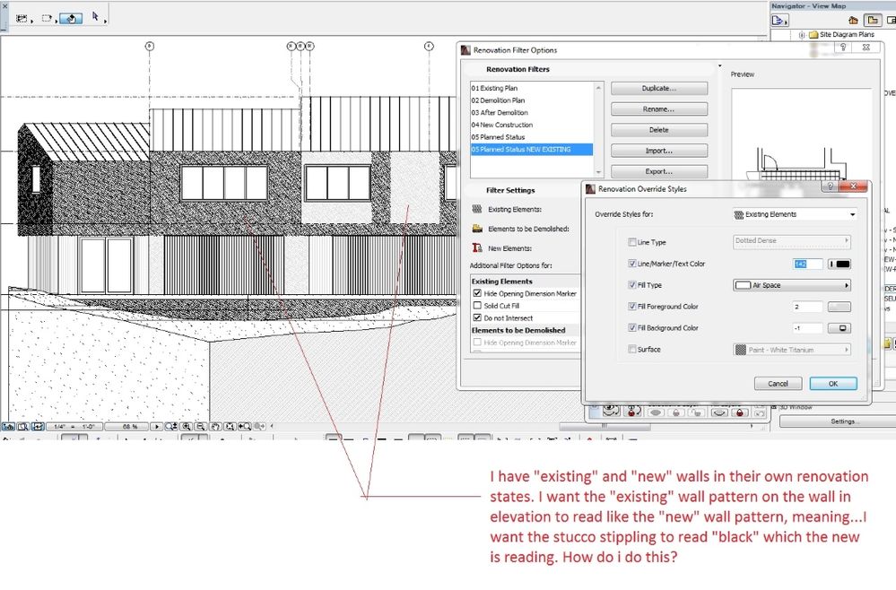

stucco textures (greys and black) - existing and new

Hi Rob,
Create another penset, that turns pen #2 to black.
I use one penset that keeps existing elements gray, which I typically use for floor plans; then I have another for the elevations, where I find it clearer to show everything all black.
Bill
Bill
