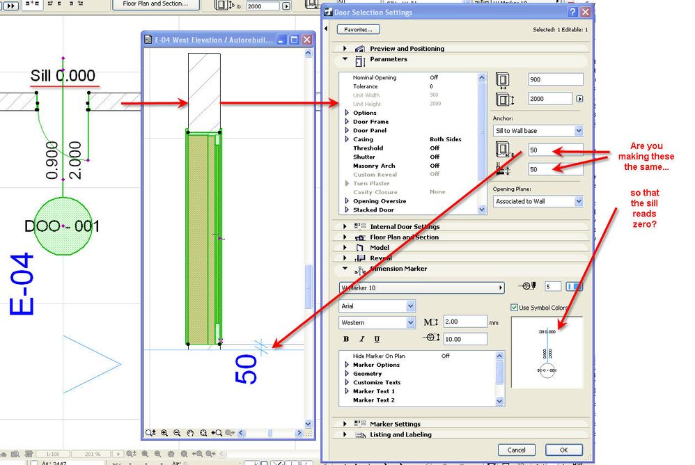

Sorry to drag this up again, but I'm still trying to convince myself that this really isn't an obscure setting. Laszlo, would you mind telling us what settings you're using, with the image below as a reference?
It's a task to get my head around the fact that it doesn't move in 3D if the subfloor thickness is set. So is it purely and exclusively for the purpose of getting the sill value in the door marker to show up with the correct information? And do builders over there, usually assume the sill is off the finished floor, or do you add further notation to it?
Any additional info to clear this up would be appreciated. Thank you.
Hunter.
Hello Hunter,
Yes, what you did in the settings Dialog is correct: we set the two fields you marked to the same value.
Yes, in Hungary, constructors know that the Sill is always measured from the finished floor level, so if they see 90 cm on the plan, then they look at the drawings, read off the floor thickness (let us say 12 cm) and so they know the sill must be 102 cm from the top of the slab structure.
Another thing I actually do in my drawings is I set the lower oversize value of the Door to the value of the sill height so I don't have that ugly wall piece below the Door in sections (that 50 mm piece in you attached image), and I can make the section details nice.
