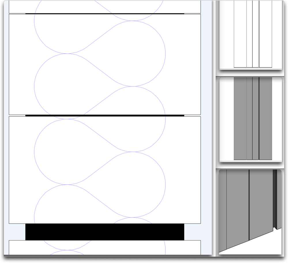

I'm not sure I understand exactly what you mean, but to get a hairline in a profile you can add a node and set the materials differently to each side of the node. These materials can be copies of the same one so the appearance is the same (just the names are different).
For a facade I want hair lines in dwg.
Smart trick about the same-profile-different name! I didn't know that.

Mats_Knutsson wrote:
/....... what if I want the vertical line to be really thin,
.....................like hairline, and go thin like that to dwg. HowdoIdo?
See attached Mats, not sure of the final result you want.

Rod wrote:
Charlie wrote:
/..So the vertical joints are hard to control./.....[/img]
Not any more Charlie, part attached.

tranthainguyen wrote:
I imported into library, then open object tool but it is not there.
That is because this is a window object and not a standard object.
You need to use it with the window tool.
Oh ok. Thanks for the tip
