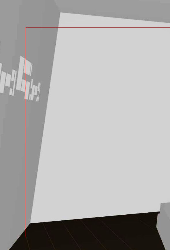

tilted lines in perspective view
Hello I'm working on a project for school and am now making 3d perspectives. Problem is that the vertical lines are tilted... Is there a way to straiten all vertical lines? I'm going to render as scetches.
I'm using Archicad 16 EDU on a PC running Windows 7 Ultimate
1 REPLY 1
Change your view so the camera angle is closer to horizontal (camera Z = target Z)
