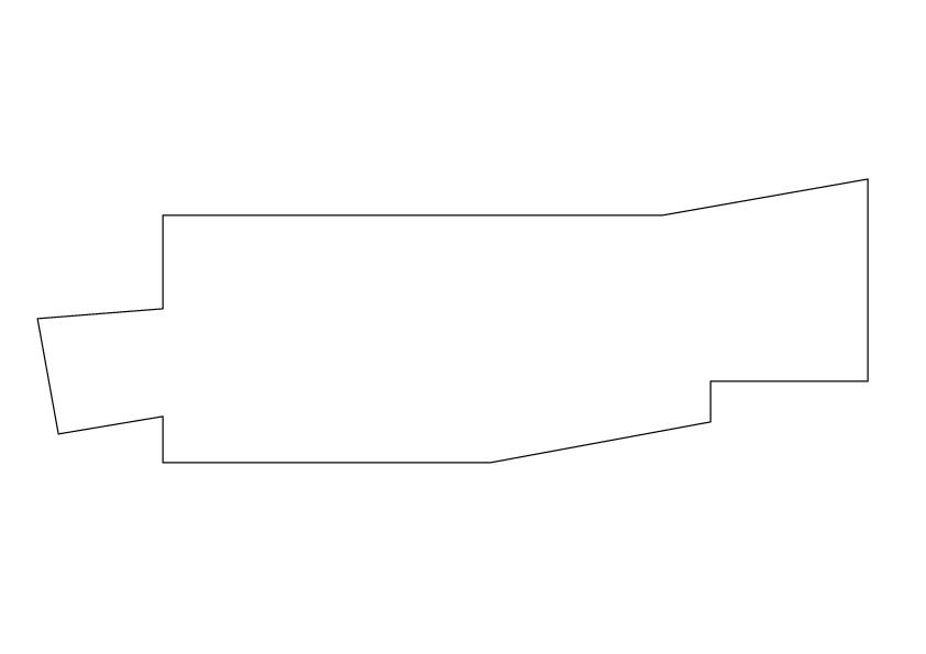

When using the mesh 3d tool by Petri, is it possible to model an object that has more than four sides (in plan view)? The roof that I am trying to model has 12 sides in roof plan view.
cheers
You can add extra points by changing the number of control points in the settings. Unfortunately it seems to self-intersect easily, which results in visible errors.
The best solution may be to either use SEO to trim the mesh3d object into shape, or you use several mesh3d objects to construct the whole roof and align the nodes to the same levels where they join.
Try both methods to see what is the best method for you. I'm not sure either solution will be perfect and display properly both in 2d and 3d.
