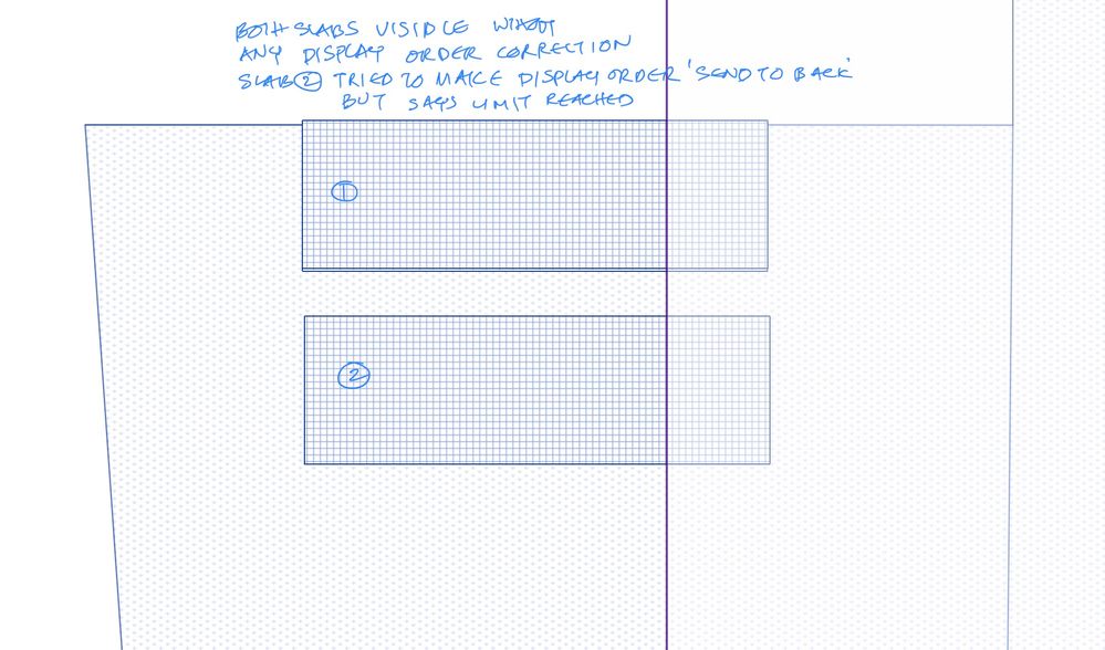

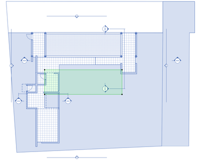

In my model, i have a pool where the slab goes below the terrain. A part of foundation is close to terrain surface. In plan, when I make the pool slab visible by applying display order, the part of foundation close to terrain becomes visible. Shouldnt the objects on top appear like being on top concealing whats below? in 3D everything is fine. How do I make this look proper?Screenshot 2023-09-07 at 4.28.13 PM.pngScreenshot 2023-09-07 at 4.24.27 PM.png

Your slabs and mesh need to have cover fills with a solid background pen (not transparent pen 0).
It looks like they do in your images.
Reset the order to defaults.
Select slab 2 and send it backwards one level.
If that does not work send it back one more level.
Do not send it all the way back - this will send it to the bottom of the stack which may work but leaves you no wiggle room.
That should be all you need to do.
There are 7 default levels for elements in the stack but there are actually about 14 level you can use.
If you get the message bottom or top stack level reached, then you have gone as far as you can.
If every element ends up in the top or bottom stack, you will have no control.
If you open the element information palette, you will be able to see the stack level of any selected element in the information it shows.
This is the only way you can see the level it is in.

If you change the display order of something to be on top, then that is what it will do.
You may also need to adjust the display order of adjacent elements as well.
The display in plan actually has nothing to do with the 3D position of the elements.

Solution

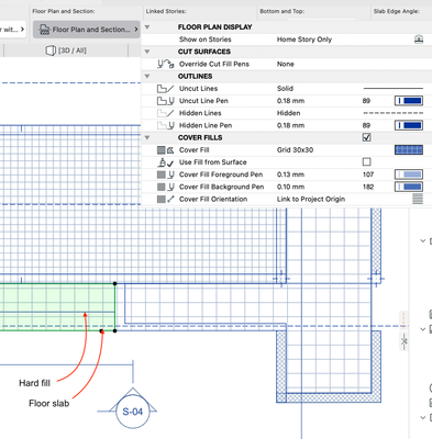

This selected slab is in top of the stack and the firm line seen ( hard fill) is at the bottom of the stack. Its still showing through. I tried changing the cover fill of slab as shown in the screenshot. Its not getting updated even after re opening the file! am i doing something wrong here?

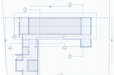

Screenshot 2023-09-09 at 2.35.51 PM.pngagain everything is see through!!😕 dont know whats happening!! this happend when i turned on the site layer.
Do your fills have a solid background colour or are they using the transparent pen (0)?
