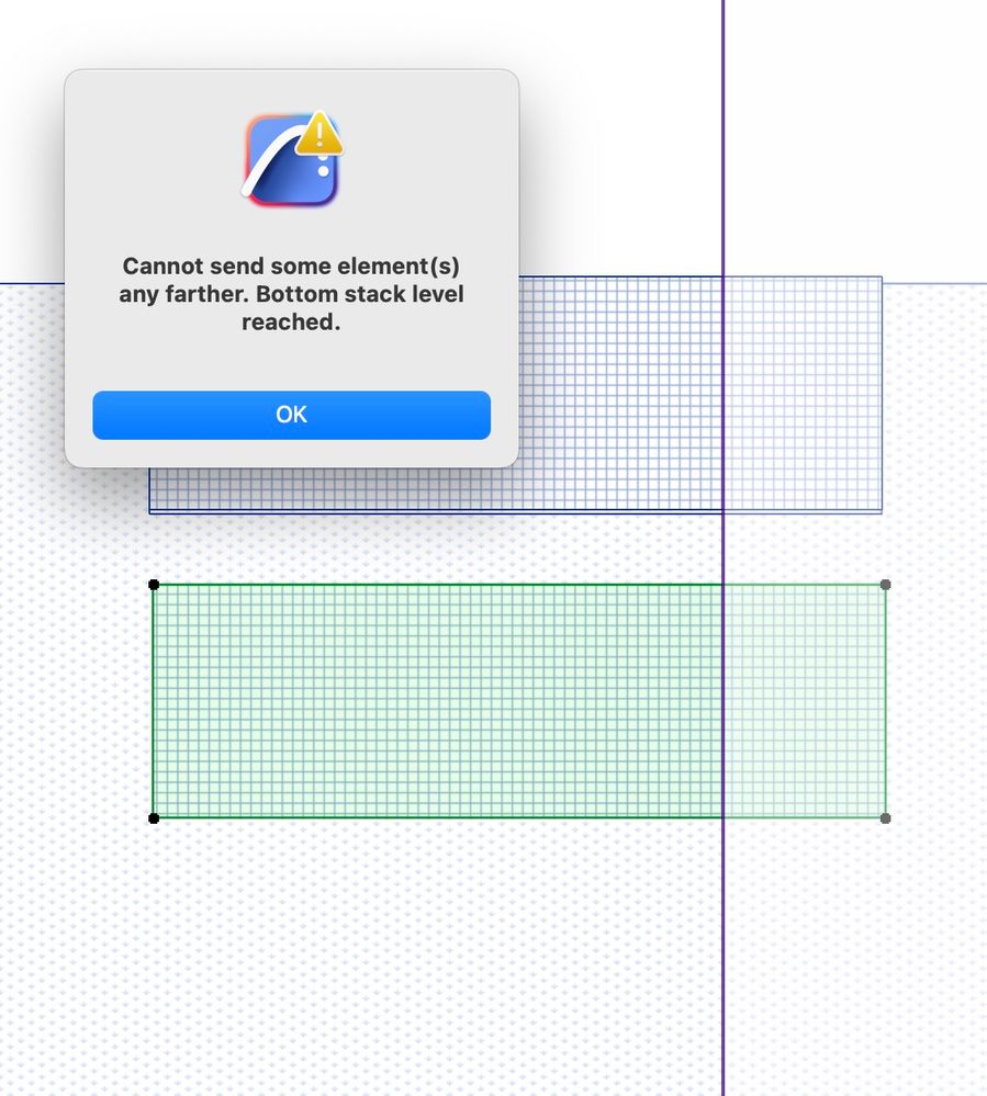

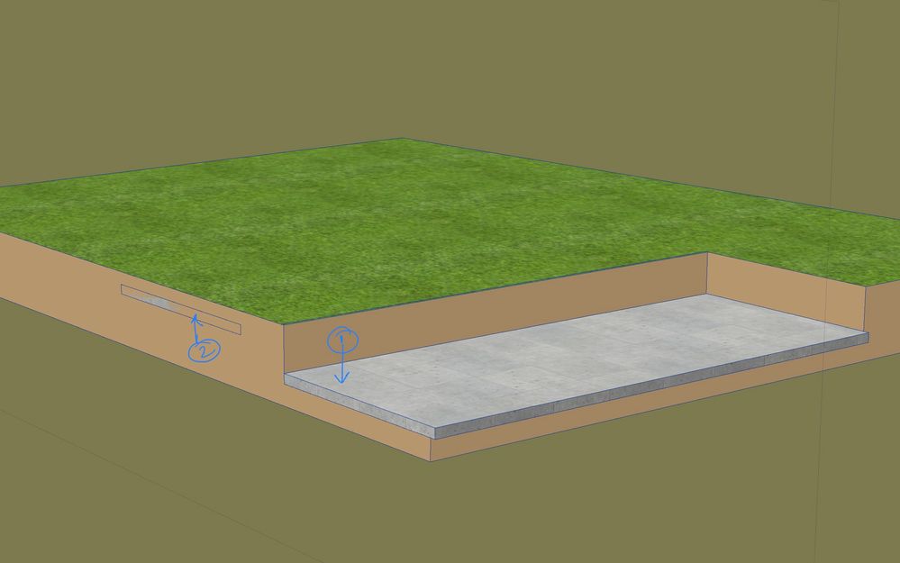

In my model, i have a pool where the slab goes below the terrain. A part of foundation is close to terrain surface. In plan, when I make the pool slab visible by applying display order, the part of foundation close to terrain becomes visible. Shouldnt the objects on top appear like being on top concealing whats below? in 3D everything is fine. How do I make this look proper?Screenshot 2023-09-07 at 4.28.13 PM.pngScreenshot 2023-09-07 at 4.24.27 PM.png
1 Solution
Your slabs and mesh need to have cover fills with a solid background pen (not transparent pen 0).
It looks like they do in your images.
Reset the order to defaults.
Select slab 2 and send it backwards one level.
If that does not work send it back one more level.
Do not send it all the way back - this will send it to the bottom of the stack which may work but leaves you no wiggle room.
That should be all you need to do.
There are 7 default levels for elements in the stack but there are actually about 14 level you can use.
If you get the message bottom or top stack level reached, then you have gone as far as you can.
If every element ends up in the top or bottom stack, you will have no control.
If you open the element information palette, you will be able to see the stack level of any selected element in the information it shows.
This is the only way you can see the level it is in.

But for situations like this when a  terrain has different levels, how the object above considered?
Every element has its own level in the display order.
The element classes are in descending order of class:
1.Annotation (Text, Labels, all Dimension types, Zone Stamps)
2.2D artwork (Lines, Circles, Splines, Hotspots)
3.Library Parts (Objects, Lamps, Stairs)
4.2D Fills
5.3D structures (Walls, Beams, Slabs, Doors, Windows, Columns, Roofs, Meshes)
6.Zones
7.Figures
So all 3D structures (5) will display automatically above zones (6) but below fills (4).
Unless you start playing with the display order.
All elements of the same class will display in the order you place them, new on top of old, again until you play with the display order.
It has nothing to do with the levels they are in 3D.

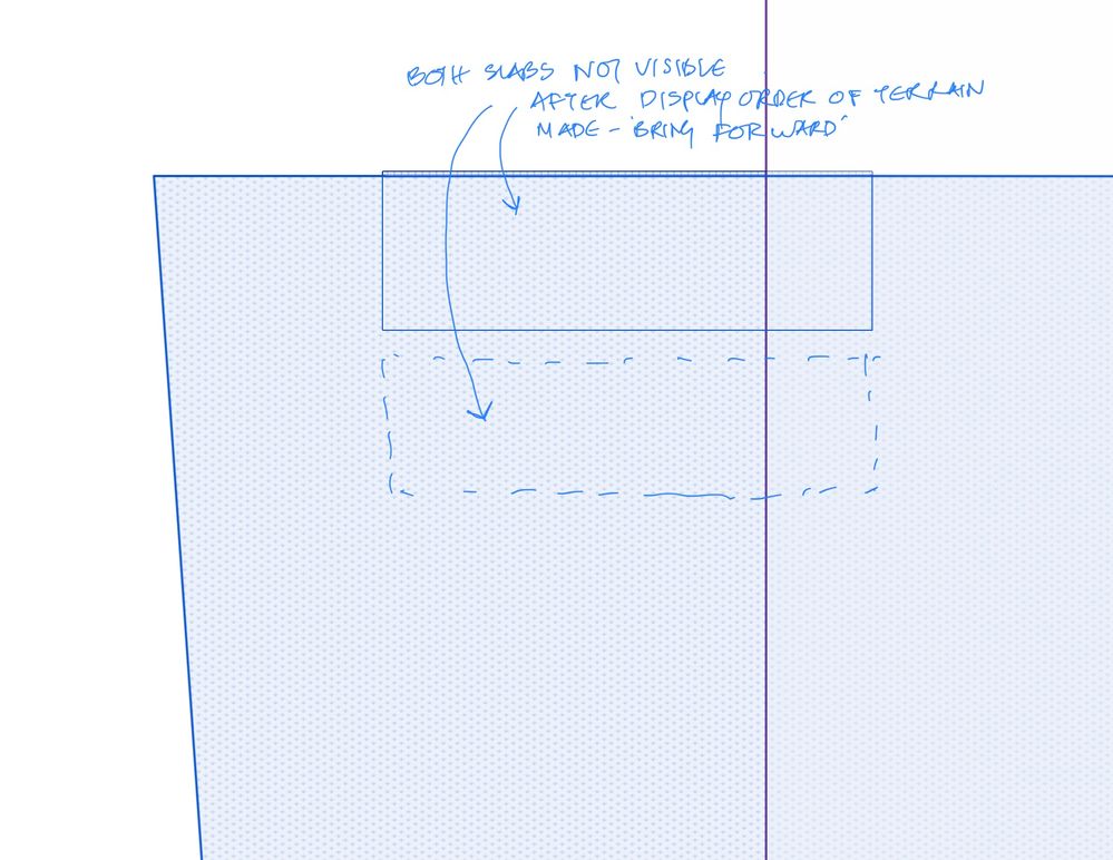

This selected slab is in top of the stack and the firm line seen ( hard fill) is at the bottom of the stack. Its still showing through. I tried changing the cover fill of slab as shown in the screenshot. Its not getting updated even after re opening the file! am i doing something wrong here?
Niranjan Das Sharma
Screenshot 2023-09-09 at 2.35.51 PM.pngagain everything is see through!!😕 dont know whats happening!! this happend when i turned on the site layer.
Do your fills have a solid background colour or are they using the transparent pen (0)?
