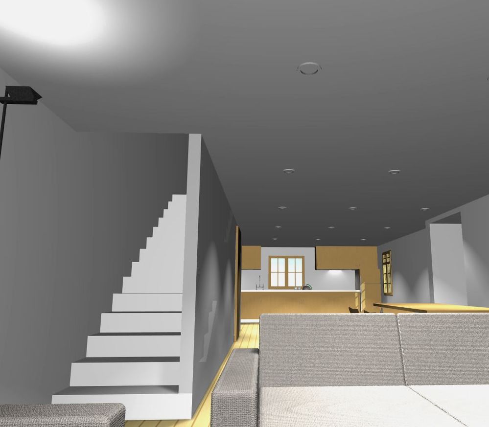

Srinivas wrote:can you explain it a little more? because i dont understand exactly the procedure
Design > Solid Element Operation
1) Select the Stair and make it the operator,
2) Select the wall and click on the target object button.
3) Action - Subtract with upward extrusion
4) execute
