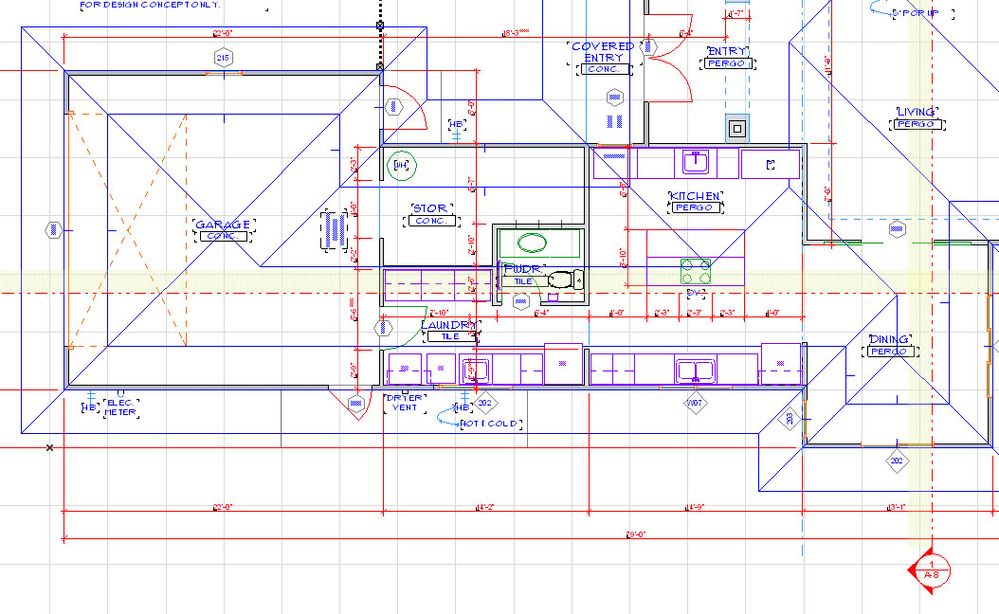

I am trying to get a building section to show up properly. I would like all of the walls that are in the plan to show up in the building section model. As of now about 80% of the walls show up but the other walls are simply not included in the section, as if they were turned off completely. I can see instead all the objects that lie behind the missing walls. If I were doing this properly I shouldn't be able to see those objects at all because they would be behind the walls in the section view. I'm sorry, I don't know how to do screen shots. Hopefully this is more descriptive.

Attached are two screen shots

there is only one wall.
There are no walls on top of one another.

Maybe I'm missing something, but which walls are not showing up? If there are not duplicate walls, have you checked wall elevations and layer settings?
