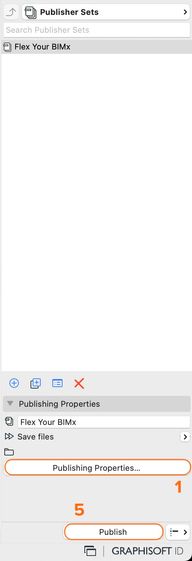

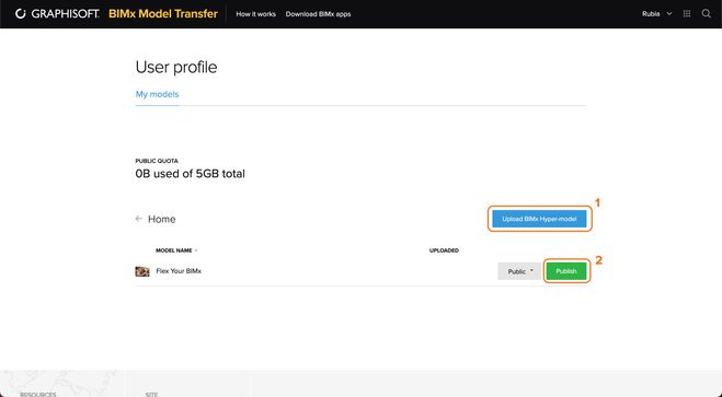

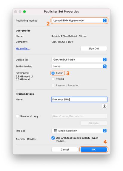

To enter the challenge, you just need to submit a link to your BIMx hyper-model or YouTube video presentation. If you choose the first alternative (BIMx Model Transfer site), follow these steps:
Option A: In Archicad, publish your BIMx hyper-models directly to the the Model Transfer site - note that this option may not be available due to our recent changes in licensing technology. We kindly ask you to go with option b if you are affected by this. Our development team is working to fix the issue as soon as possible.
Option B: Publish your BIMx hyper-models locally and upload it to the Model Transfer site manually.
More detailed instructions on publishing locally here.
