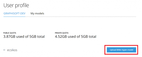

Direct Hyper-model upload via your web browser is available on BIMx Model Transfer site.
You can easily upload a previously exported Hyper-model to your private storage. This option is useful when the publishing process in Archicad is long due to the file size and your internet connectivity is hectic. You might want to upload your Hyper-model in two steps:
This article describes step two.
You need to be signed in with your Graphisoft ID on BIMx Model Transfer site and need to navigate to one of your folders to have this option available.

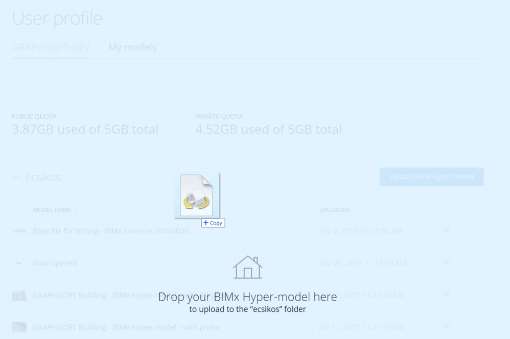

You can select the file to be uploaded by browsing in the file open dialog or you can simply drag and drop it to the target folder.

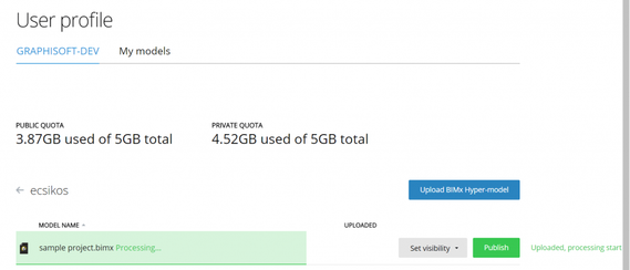

From now on the name of the person who uploaded or last updated a hyper-model will also be displayed on the download page of the Hyper-model. Thanks to this info it will be easier to track changes of the Hyper-models in the design office's storage space.
Just like when you upload from Archicad you can upload to a private folder if you have an active SSA (Software Service Agreement). If you don't have SSA, you can upload the model in the public area of the site.
Let's see the steps of the upload:

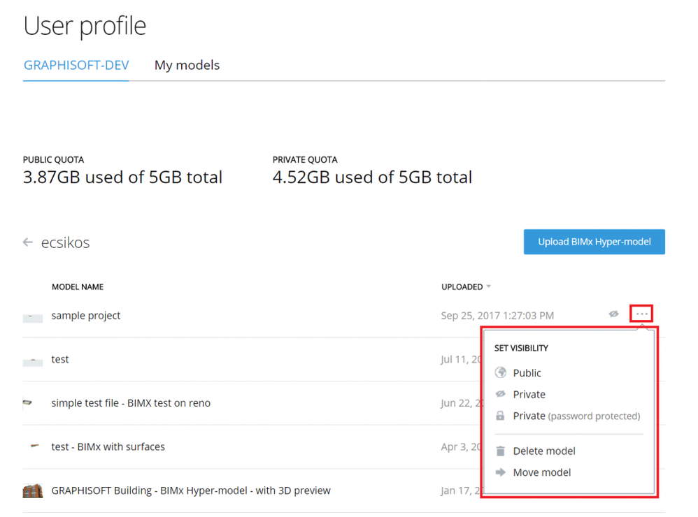

You can also change the visibility of the hyper-model after uploading it to the site.
