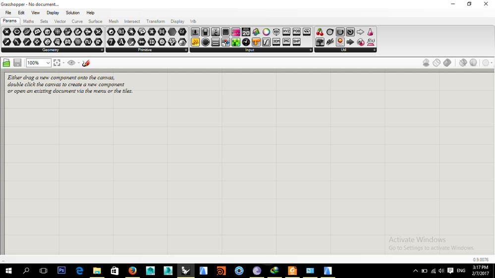

I already installed archicad 20 and the latest version of GH then i installed Gh -archicad live connection 20 but i found no component of archicad in component bar but in archicad things go well
I used windows 10 X64

You need to make sure Archicad and the GH Live Connection are all for exactly the same build.
Dos this help ...
http://archicad-talk.graphisoft.com/viewtopic.php?t=56136
There is a link to all the GH connection versions for the various Archicad versions.

Sometimes also Grasshopper doesn't add them on his own. You'ld need to add the components by hand.
First you can check if it is successfully installed by double clicking the canvas which will let you search for components.
