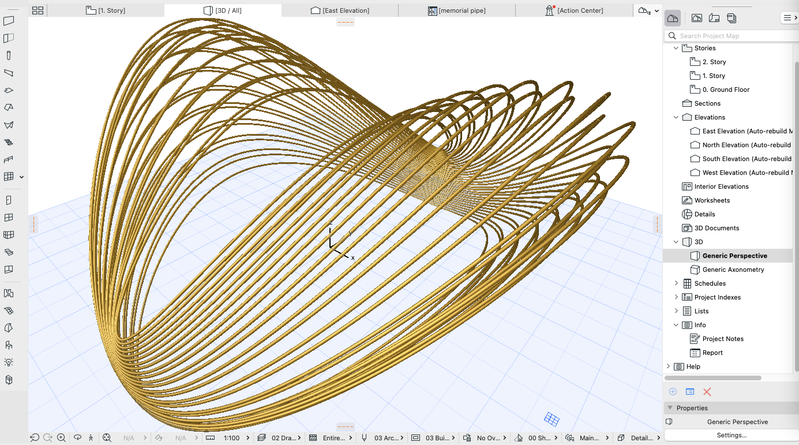

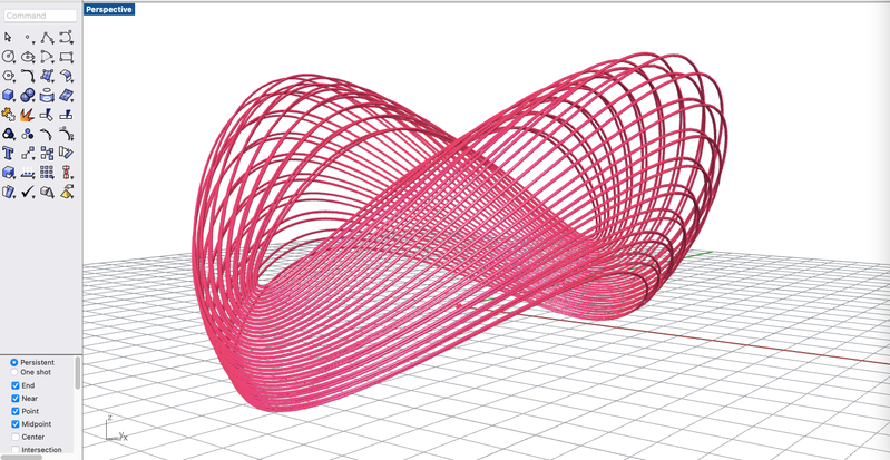

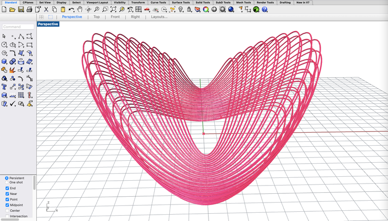

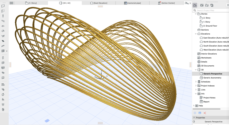

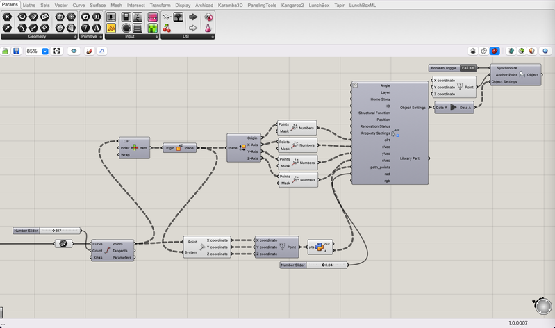

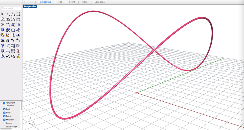

4. THE TUBE COMMAND
The TUBE command in GDL is very useful when creating shapes similar to Sweep One Rail, or when generating parametric piping via Grasshopper. The exam project is shown below.
The Sousse and Bardo Memorial designed by George King Architects.

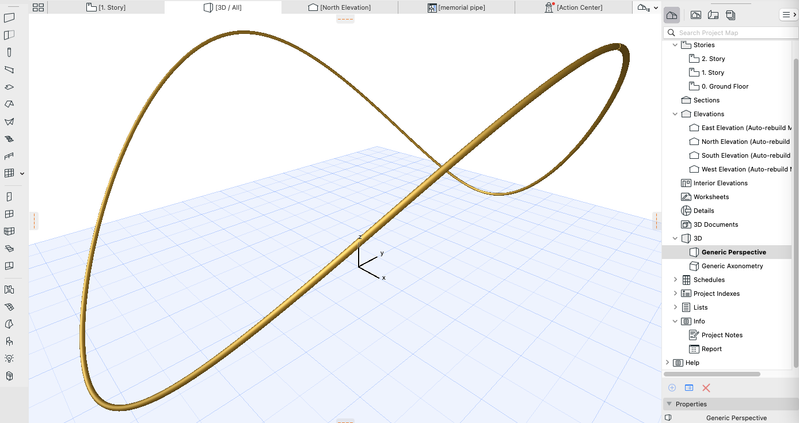

First, create the geometry and form in Grasshopper. This form is generated using Interpolate Curves and the Pipe component in GH.

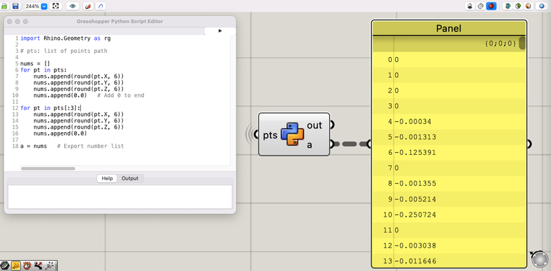

Next, the method is to simply transfer the curve from GH to GDL in order to create the pipe using the TUBE command. For clarity, I isolated one simple example: the path points are taken by dividing the curve. The higher the number of divisions, the more accurate and smooth the result will be.
The GH scripts and GDL script use the transform plane method (XForm) that I mentioned earlier.
The Python script is used to add the status code and to loop the first three points for the TUBE command. Since TUBE requires two dummy points, we need to replace them.

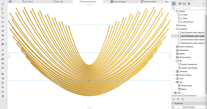

Here we go. We can create the entire pipeline in Archicad using the DataTree from GH, where each pipe is generated as a separate GDL object
Elevation/ Section View.

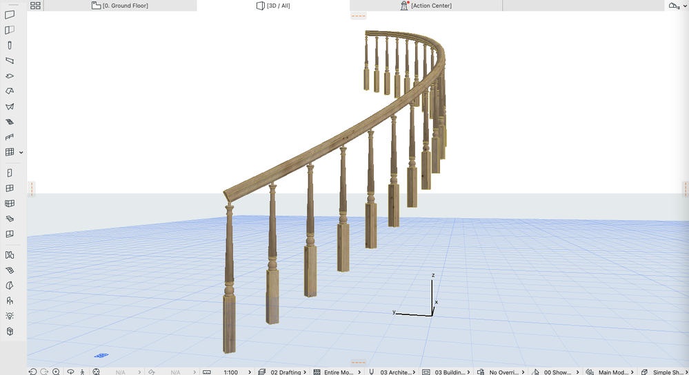

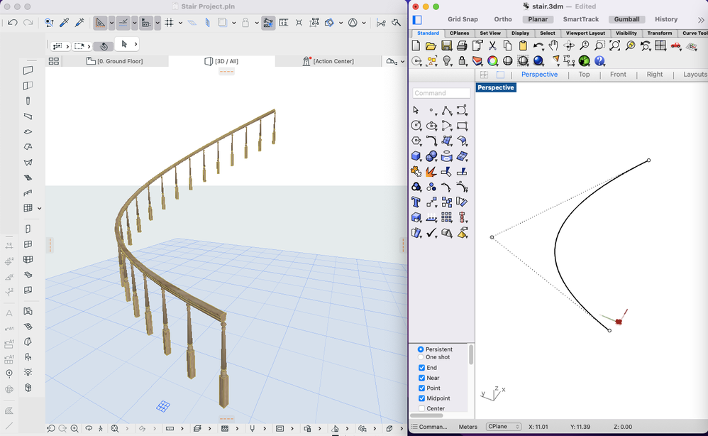

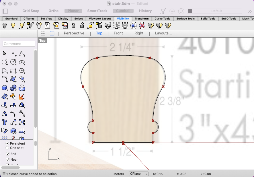

5.  PROFILES
Just sharing a few of my ways to handle profiles in GDL — nothing special, but they help reduce manual work.

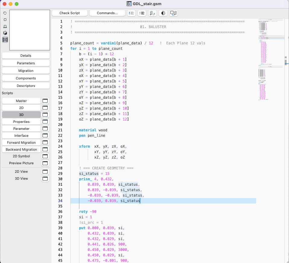

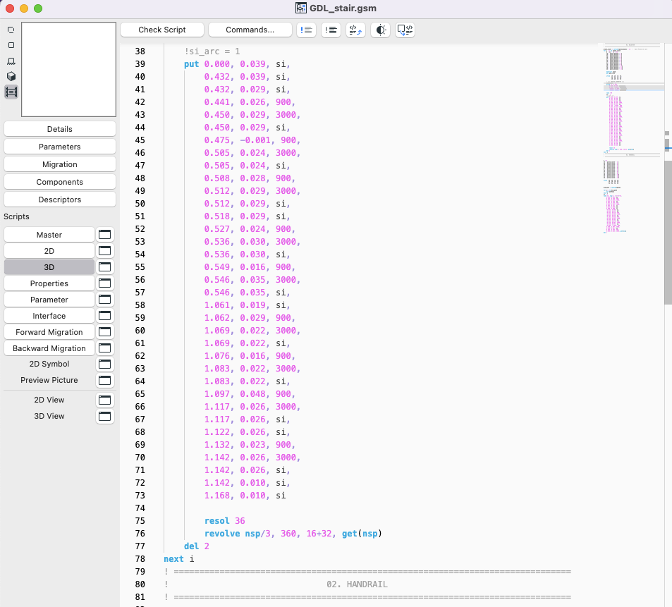

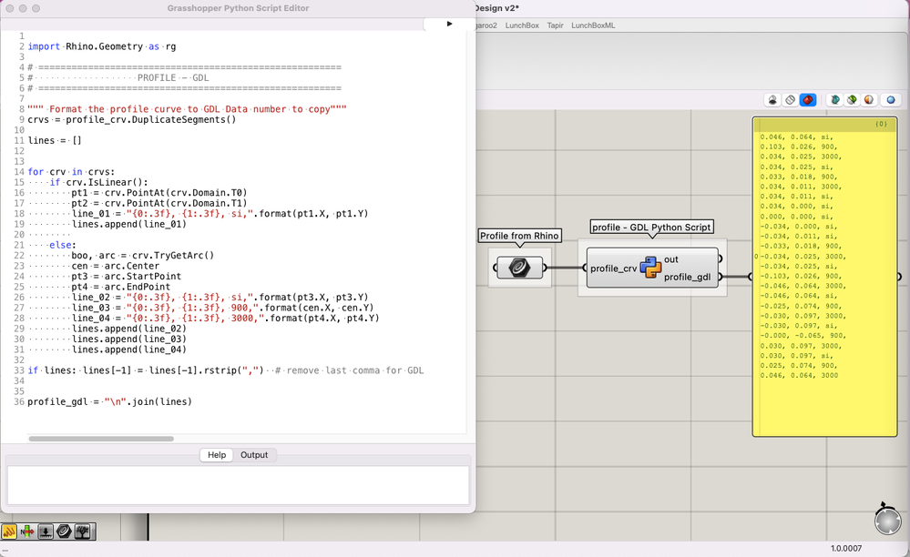

You can transfer any profile curve from Rhino to GDL using a Python script in Grasshopper, as long as the profile consists of lines and arcs only. The script formats the data into GDL code, making it easy to copy directly into your GDL object. The profile curve must be drawn in the XY plane at the Origin point.
si is a status code integer controlling the visual; assign its value before the code, e.g. si = 15.

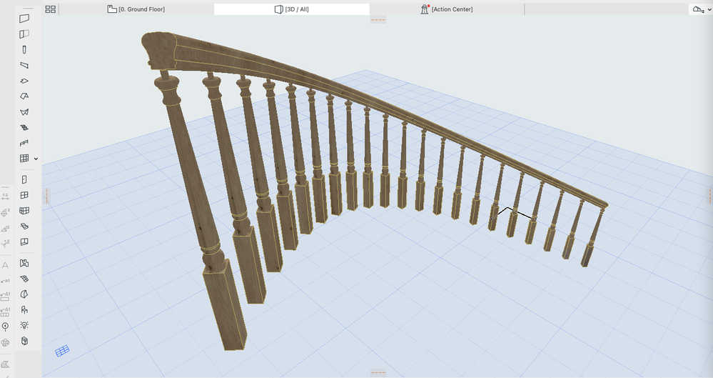

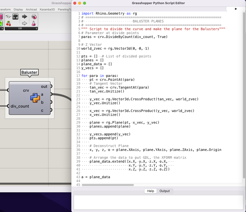

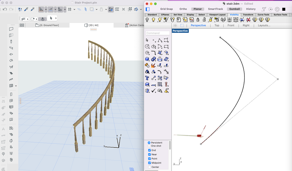

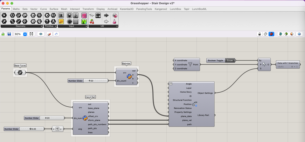

The rail path curve was drawn manually in Rhino, then processed with a Python script in Grasshopper to divide it and send the planes to GDL via the Live Connection. All components are created within one Stair object.
The rail shape is controlled directly by the curve in Rhino; just move the curve’s control points to change the form.
Python script for generating baluster planes.
  Stair GDL Script: Balusters
