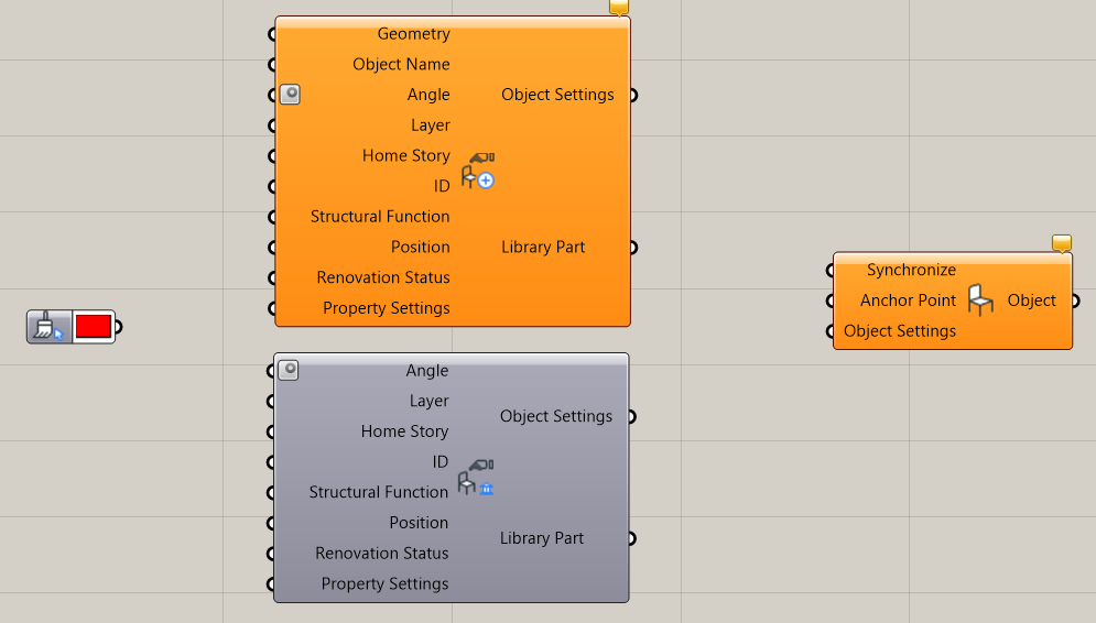

Also apologies I realize I hadn't included the screenshot of the object settings as well.

Josh Verran
Thanks for the link Gino.
I hope I read the sections correctly, you're screenshot above seems to cover all the relevant info with regards to my original query.
From what I understand, the Surface Input Component is only available for the Object Settings Node. Furthermore, it only works when utilizing an existing object (library part), not for creating new Objects. Also, it only works if you do some editing of the GDL code.
I'd add a wishlist item to make the Surface Input Component available for other nodes, but it's likely due to the complexity of the connection as to why it's not available now.
