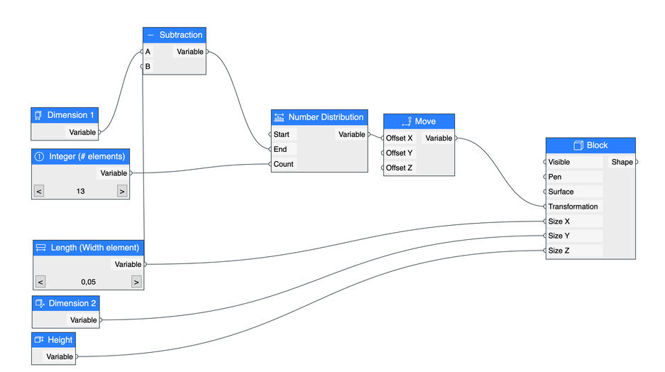

New at paramo, i'm trying to make the number of post parametric without editing in paramo. For example, each post is 8 x 3 xm and the space between them is 3 cm. I would like to reduce or increase the count of post in object property keeping the same value ( post dimensions and space ).

Hello Dany,
Setup 1: Distribute
Dimension 1 will be divided in the number of elements you want.  If you change dimension1, the gap between the elements will increase/decrease.
In this option there is a substracion node:  end of number distribution = dimension1-width element.  By doing this, the object is "stretchable" in 2d&3d

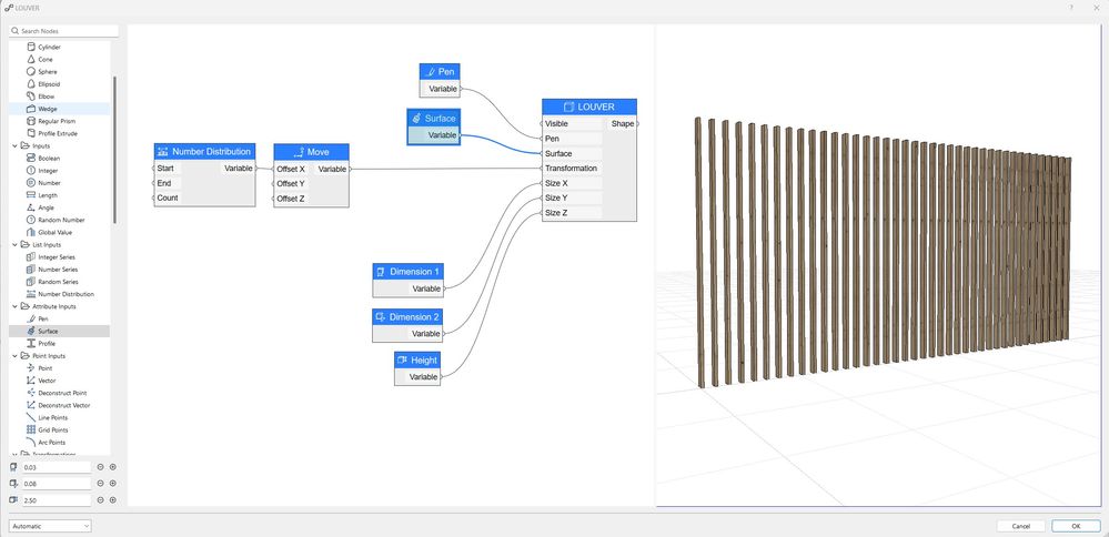

Setup 2: Number series:
In this setup you can choose the width of the element + width of the gap.  When you change dimension1, extra elements will be added.

Hi @DanyThailand
It could be done differently for sure, but here I am sharing a possible way. Dimension 1 will be the length, Profile A and B the post profile sizes and you could choose the distance too.
