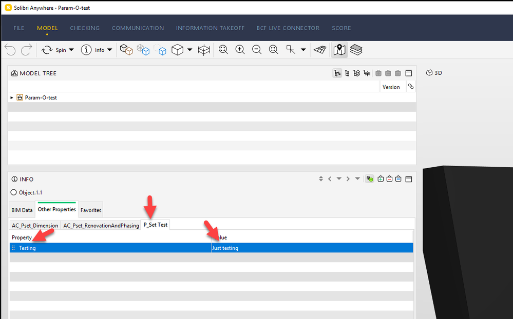

Kamelite
Made a test, a simple cube, in Param-o, gave it a property and a P_set, then exported it to IFC. Something like that?
