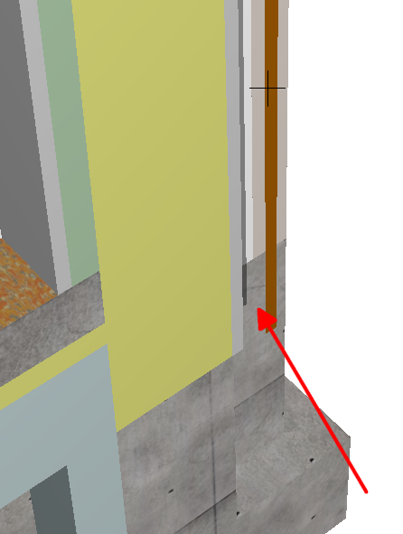

I am just facing the same problem – working on six houses, its constructions (building materials of the walls) are the same and the only difference is the color of the exterior skin. As I am preparing a model for rendering, I tried to override just the material of the outer skin – and the corner are badly connected in 3D... I don't want to define six different building materials or composite walls just because of the color of the plaster on the final renderings...

On more problem, - when a material within a composite is transparent, the whole wall becomes transparent from that layer / material
One more screenshot
