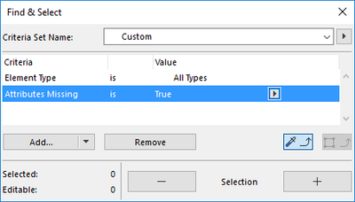

Good morning, this problem is still not solved, the same thing happened in our office a couple of times with AC25, last one was yesterday, we delete the layer, select the delete elements option, the layer gets the deleted but all the elements remain with the layer as a missing attribute. It can be a really annoying thing because you have to scourge the whole file for them elements that you want deleted in a simple manner. There is a workaround, first select the move to other layer option to a temp layer and then delete the temp layer, but it shouldn't be like this. Cheers!

PS - does Find & Select searching for all elements with attributes missing help find them?
