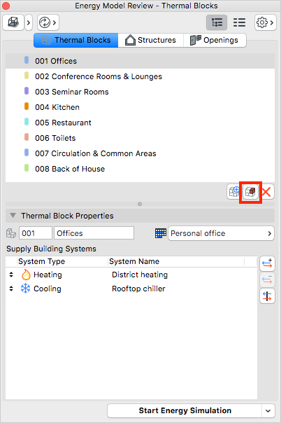

3. In the Thermal Blocks tab, click the Add Zone to selected Thermal Block button to open the assignment palette.

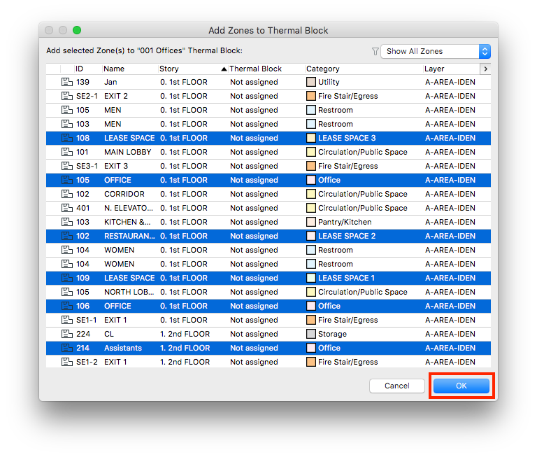

4. Select the zones to add to the Thermal Block and click OK. Repeat process for all other Thermal Blocks.
NOTE: Zones do not need to be contiguous to be part of the same thermal block.

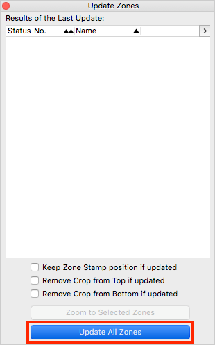

6. Click the Energy Model Update Options button and select Update Zones to open the Update Zones palette.
NOTE: The building structures are not read until the zones are updated.
7. In the Update Zones palette, click the Update All Zones button.

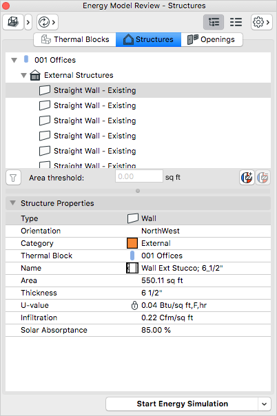

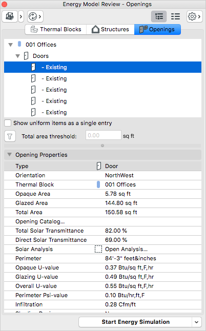

9. In both the Structures and Opening tabs both structures and openings have now been calculated. For more information on how the Structures and Openings are calculated you can visit these User Guides: Structures Tab Page and Openings Tab Page.
