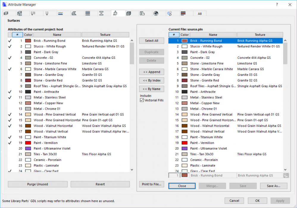

Assume you have a fill with ID#31 with the name "Tiles" in the host file, and you have a fill with the same ID#31, but with name "Concrete" in the Hotlinked file. In this case, the "Concrete" fill will be appended to the host file's attributes, but since the ID#31 is already taken, it will get a new ID (the next available number in the host file, say #62). The hotlinked elements using that fill will then refer to this attribute (#62, Concrete). This does not matter much as far as display is concerned, elements will look as expected (with the "Concrete" fill). However, this might be a slight inconvenience when it comes to using the Attribute Manager. Attribute manager has two functions: "Append" and "Overwrite".
  • Append will copy over the attribute from one file to the other, and assign an unused ID to the attribute.
  • Overwrite will overwrite an attribute of one file with the attribute in the other file that has the same ID.
Example: You have "#31-Tile" in file "A" and "#31-Concrete" in file "B":
  • Appending attributes from "B" to "A" will create a new fill: "#62-Concrete"
  • Overwriting attributes from "B" to "A" will delete "#31-Tile" and replace it with "#31-Concrete"
