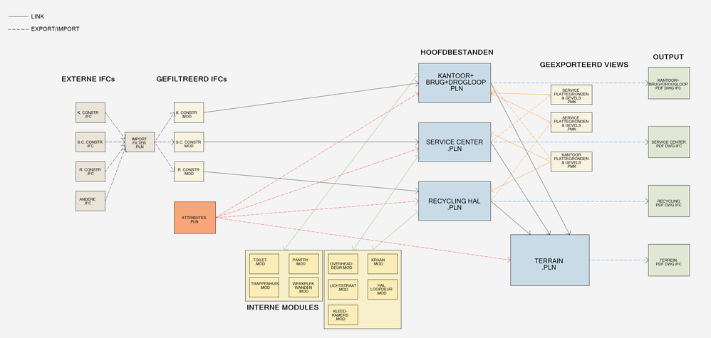

Recently we had to split a large project in 3 different files which are linked to e "Terrain" file.  A major complciation is that we're using IFCs from the civil engineer which get imported into a "Filter" archicad file, where I delete unnecessary information and then I export 3 different "Structure" archicad files to be imported into the 3 main project files. Each file produces it's own drawings while the terrain file is used for 3D and the masterplan.
I made another "Attributes" file and during the first month I was editing attributes only from this file and then importing them into all the 3+1 other files. I have always used the import by index option, and since all project files excluding the Attributes files are on the BIMcloud I always pay attention that I have reserved everything before importing.
Even so i was noticing that a lot of duplicates were being formed e.g. profile HE280A (46). At one point i got lazy and sometimes i started editing attributes directly from the main files and then exporting them back to the Attributes file, in order to later seed the rest of the linked files. I thought this wouldnt cause any issues.

Thank you for the long post! Could you please provide some information on the cause of the milions of dupplicates that I am getting? Even if I fix all the attributes they'd continue to get messed in the future.
Considering the diagram that I posted Is there a way to start again? Purge most attributes and start from the structural models maybe?

Hi Stefan,
The duplicates is one part of attributes that I’ve yet to fully get to the bottom of. I believe at side point in the last few versions of Archicad with complex profiles they realised that it couldn’t just assume that an existing profile with the same name could be just assigned to an element in a hotlink. So instead if it believes the profile is different to the one already in the file, it just creates it as a new complex profile attribute with the same name but (1),(2) and so on if it exists in the hotlink. I’ll try and do some testing to test my theory properly.  The other attributes don’t work this way.
In terms of a clean up process. Work out which file is going to be your single point of truth. Your already created attribute file is probably going to be best for that. Purge all unnecessary attributes from your other files is going to help as it’s then going to free up index numbers so you can reindex the attributes in all the other files so that the attributes that should be match are in the same index numbers as your master attribute file. Once you’ve got all the attributes index numbers aligning you can starting bringing over the latest version of the attributes from the master attribute file, using by index.
setting up ranges of index number can be very helpful too, eg are your structural IFC imports you make sure those attributes start at 2000 for example and a different IFC starts at 3000. This is where you IFC filtering fine will be essential.
We have even gone so far as to convert a whole IFC import to a morph and sign a single BM and surface to all those morphs to make attributes infection from IFC files. This removed your issue with complex profiles heading to be to be handed too. But does matter to more complicated to interact with those ifc model elements.
once you’ve got everything all organised your process moving forward would be to only every edit, remand strives in your master attribute file, and always do a manual attribute ‘sync’ or update in all the files from the master attribute file before doing any hotlink updates. Never never never update any hotlink before manually synchronising your attributes.
Lastly, don’t forget about copy paste as another source of attribute infection too. Even if you instruct everyone in the team to never copy paste directly into the file. Someone inevitably will. The easiest way to make them never do it again is making them clean up the attributes after they do. 🤣
 if you are working in teamwork it is possible to lock down attribute modification and importing, which should prevent attributes polluting via hooting and copy paste. However I’ve never tried it on a live project.
